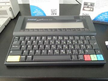

| NC100 with a UK keyboard | |

[edit | edit source]-
A German NC100 at its main menu
