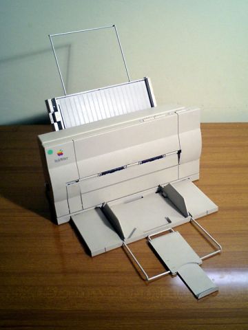

Original StyleWriter with its cut sheet feeder and rod support fitted (All About Apple museum, CC BY-SA 3.0)
