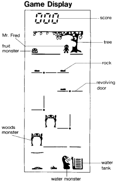

[edit | edit source]The display is a vacuum fluorescent tube mounted on the main board, viewed through an oval magnifying lens and a printed film.[3] Its part number has not been published; a marking ending "8BM24T" is printed on the board beside it.[3] The tube's segments are this game's own shapes (Mr. Fred, the tree, the monsters, the doors and the tank), so a replacement can only come from another copy of the game.[1]
