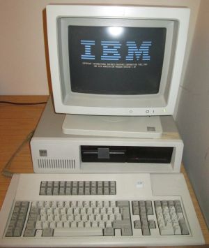

IBM 3270 PC Troubleshooting Guide
This guide documents fault diagnosis for the IBM 3270 PC (machine type 5271). POST is the standard IBM PC XT (5160) sequence in the 1xxโ19xx range plus 28xx codes for the 3278/79 Emulation Adapter and 32xx codes for the 3270 PC Display Adapter / APA / PSS subsystem.

[edit | edit source]A working 3270 PC boots:
- Standard IBM PC XT POST (no error message, single short beep).
- Keyboard adapter card initialises and exposes its video BIOS.
- 3270 PC Display Adapter video appears.
- IBM PC DOS 2.0 or 2.1 boots.
- AUTOEXEC.BAT loads the 3270 PC Control Program.
- Control Program initialises:
- 3278/79 Emulation Adapter โ connects to 3174/3274 cluster controller.
- APA / PSS cards (where fitted).
- Multi-session windowed display on the 5272 monitor.
- Control Program presents the user with 4 mainframe sessions + 1 DOS task + 2 notepads in a window layout.
If any of these does not happen, stop and diagnose at that stage.
