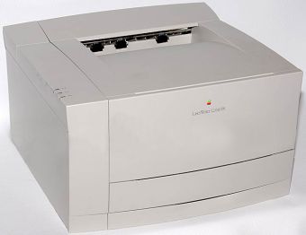

A LaserWriter 12/640 PS (Mikerajchel, Wikimedia Commons, public domain)
