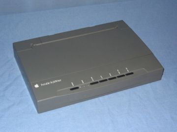

Fault-finding for the Apple Portable StyleWriter, from Apple's Portable StyleWriter Service Source. The printer reports faults with its three lights and with beeps, and the Macintosh printer driver shows a matching message. Apple's symptom charts try the cable, software, paper, cartridge and battery, then replace the whole printer.[1] Purging and battery care are on Apple Portable StyleWriter General Maintenance.
Error lights and beeps
[edit | edit source]Apple's chart lists the driver's message, the state of the Power, Error and On Line lights, and the fault. In the chart, "blink" means the light is flashing.[1]

The light states are drawn from Apple's chart. For the battery-charging and battery-error rows the drawing does not match the wording in the message column, so go by the message and the fault name.[1]
