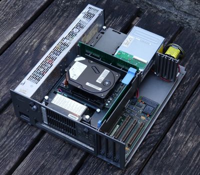

A Model 50 Z with the cover removed, showing the planar, the drive structure and the drive riser card.

Opening the System Unit
Tools: a Philips screwdriver and an anti-static strap. IBM stowed a small plastic drive-structure removal tool under the battery/speaker assembly; it is the right tool for the white plastic snaps inside.[8]
  1. Power off and unplug everything.
  2. Loosen the two captive cover screws at the rear. They are captive, so when they spin free they are undone.
  3. Slide the cover forward about two inches, then lift it off.[8]
If the cover lock is locked and the key is lost, unscrew the two rear thumbscrews, push the cover forward as far as it will go, then lever a 4โ€“5 mm gap between the cover and the rear wall with a large flat screwdriver โ€” enough to slide the cover over the locking tab. Once open, pull out the lock and remove the locking bracket. IBM's own answer is to order a replacement cover-lock assembly, which comes with two keys, and force the old lock with one of them and a pair of pliers.[8][2]
Closing it is fussier than opening it: set the cover about an inch back from the front, let it engage the guide at the bottom rear of the case, then slide it forward. If the diskette drive will not line up with the bezel, check that the drive is fully seated on the drive shelf rather than forcing the cover.[8]
Taking the planar out is a defined sequence and skipping a step will crack plastic: remove the adapter cards, the diskette drive, the fixed disk and the drive riser card; on the Model 50 also remove the fixed-disk adapter and the exhaust fan assembly; use the removal tool to lift every white plastic snap, including the one hidden under the speaker assembly, and pull the drive structure straight up; then pull the power supply. Three screws hold the planar. A 1/8-inch centring pin in the base mates with a hole in the planar next to the large inductor, so lift the planar straight up rather than tilting it or you will lever against that pin.[8]
