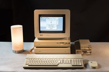

Atari Mega ST with SM124 monitor and Megafile hard disk. The clock battery housing is on the top of the case, behind the left fan vent.
