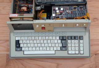

| The IBM PALM controller card (Card J2) — all 13 bipolar "Dutchess" gate arrays in metal-can packages are visible, with the central round metal-can oscillator and three small DIP devices in the upper-middle region. (Photograph: Christian Corti, Stuttgart Computer Museum, ©1999–2017, used with attribution.) | |

| Used in | IBM 5100 (1975), IBM 5110 (1978), IBM 5120 (1980) |

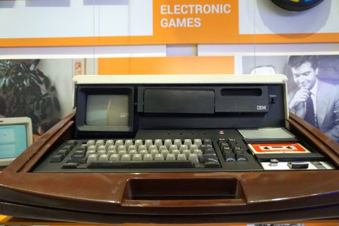

Origin: SCAMP, 1973
editPALM was originally developed for the SCAMP (Special Computer APL Machine Portable) prototype built at the IBM Los Gatos Scientific Center / Palo Alto Scientific Center under Dr. Paul J. Friedl between January and June 1973. SCAMP was commissioned by IBM General Systems Division (Atlanta) — specifically GSD engineer Dave Slattery — to demonstrate a self-contained portable computer that could run the APL programming environment.
SCAMP's hardware was sourced across multiple IBM divisions:
- Processor — the PALM board, from the PALM Development Group at IBM Boca Raton (led by Roger Abernathy).
- Memory cards — from IBM Germany.
- Keyboard — from IBM Raleigh, North Carolina.
- CRT — sourced from Ball Brothers, Inc.
- Secondary storage — a Norelco / Philips audio cassette deck.
SCAMP ran an IBM 1130 minicomputer emulator in PALM microcode, allowing it to host APL\1130 (APL for the IBM 1130). The prototype was demonstrated to IBM management in late 1973 and led directly to the IBM 5100 production programme.
PC Magazine in November 1983 retroactively called SCAMP "the world's first personal computer".[6] The SCAMP prototype itself is preserved at the Smithsonian National Museum of American History (object record nmah_334628).
