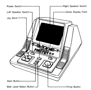

[edit | edit source]- Take out the cells. Peel the sticker off the end of the joystick, undo the tiny Phillips screw beneath it and lift the knob off.[8][6]
- Remove the six screws in the base (they drop out if the case is tilted back) and lift the top straight off. A vinyl overlay covers the board and the control panel unclips.[8][6]
- A small screw in the middle holds the control board, which stays joined to the main board by the ten-way cable. Handle that cable gently: it caused Bryden's sound and joystick faults.[8][4]
- One screw at the back and one at the front hold the main board, and the DC socket lifts out of its hole with it. Unsolder the battery wires, marked positive and negative, to free the board.[8][4][5] The full sequence is on Grandstand Firefox F-7 General Maintenance.

| At switch-on | A tune plays and the display lights, skill level 1 at the top right | [9] |
| Sound | Music from the left speaker, effects from the right, each with its own switch | [9][10] |
