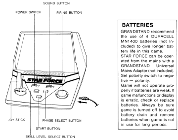

[edit | edit source]Star Force runs from four C cells or a mains adaptor set to negative polarity, a nominal 6 V.[5] Its microcontroller is an NEC D7528C, read as D7528C-016 by the Handheld Museum.[1] The main board, marked 96291 with an Epoch logo, carries the display tube (silkscreen V01: FIP10AM33T) and, along the edge beyond the tube, a round TDK transformer, small transistors and the electrolytic capacitors.[3][4]

- ↑ 5.0 5.1 5.2 5.3 5.4 5.5 Grandstand, Star Force instruction booklet (distributed by Adam Imports Ltd, Harrogate; printed in Japan), hosted here as File:Grandstand Star Force Instructions.pdf. p. 1: four Duracell MN1400 cells, or the Grandstand Universal Mains Adaptor with its polarity switch set to negative; at switch-on an electronic melody plays and the display lights; the game is set to skill level 1 ("L1" at the top of the display) and phase 1; with the sound switch off the game plays without sound effects; START sounds and shows the number of lives. p. 2: four skill levels and seven phases, chosen with the skill level and phase select buttons.
