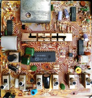

Grandstand 4600 colour - PCB
The board of a Grandstand 4600, a six-game console in the same style of case as the 5000; this is not a 5000 board. No photograph of the inside of a Grandstand 5000 has been published.

The 4600 board, for comparison
The 4600's board, in the same style of case, has C-numbers printed beside its parts and about ten electrolytics, of which two markings can be read: C38 is 10 µF and C37 is rated 16 V.[9] The full reading is on Grandstand Model 4600 Capacitor Replacement Guide. The 5000's cycle games, throttle input and GAME switch have no counterpart on the 4600,[2] so its board is likely to differ at least in those parts; whether its supply and RF sections match the 4600's is not known.
