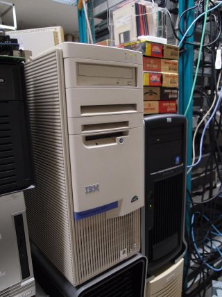

IBM PC Series 300 Maintenance Guide
The IBM PC Series 300 covers IBM's PC 330, 340, 350, 360 and 365 and the PC 300GL and 300PL desktops of the mid to late 1990s, sold under machine types in the 62xx, 65xx and 68xx ranges. IBM serviced them from the IBM Personal Computer 300 Series, 700 Series, IntelliStation Hardware Maintenance Manual (S83G-7789), which gives the power checks, POST and beep codes, memory rules, BIOS procedures and parts lists.[1]

Identify the machine type
[edit | edit source]The machine type and model are on the label (for example Type 6862). IBM's service manual and technical information manuals are organised by type:[1]
