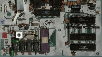

Grandstand-video-entertainment-computer-pcb
Grandstand Video Entertainment Computer main board: RF section top left, electrolytic capacitors at the top right of centre, CPU and PSUs on the right, video RAM bottom left (Incog88, CC BY-SA 3.0).
