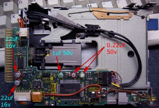

Diskette drive
The 8580's diskette drives take their power through the interface. The -Axx machines use a pin-connector drive; the earlier models use the card-edge drive P/N 90X6766, FRU 72X8523.[12] Al Savage found that all three of his 8580 drives would not read diskettes, and repaired both Mitsubishi units by replacing surface-mount electrolytics that were open-circuit or very high in ESR. On the Mitsubishi MF355W-99M3 he marked five:[12]
Replaced capacitors, Mitsubishi MF355W-99M3 (Al Savage)
Value Quantity
22 µF 16 V 2
1 µF 50 V 1
0.22 µF 50 V 2
Mitsubishi MF355W-99M3 PS2 diskette drive capacitor locations
Al Savage's photograph of the MF355W-99M3 logic board with the five failed capacitors marked. (Image: Al Savage, via Ardent Tool of Capitalism)
The ibmfiles.com repair of a Mitsubishi PS/2 drive replaced two surface-mount electrolytics with 10 µF through-hole parts soldered to the pads, so boards differ; read the values off your own drive.[13] In an exchange with Alan Douglas reproduced on Ardent Tool, repairers used surface-mount electrolytics for the 22 µF and 1 µF positions and ceramics for the 0.22 µF positions, since 0.22 µF electrolytics are hard to find, and tantalum chips for the others. The same exchange recommends cutting the old capacitors in two with flush cutters, removing the rubber seal and working on the leg stubs from above, because pulling or overheating a part can lift the pad.[7] Jim Shorney reports that leaked electrolyte contaminates the joints so that the solder will not melt and the leg pulls away first.[14]
