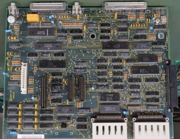

IBM PCjr (4860) motherboard
This guide covers capacitor work on the IBM PCjr (model 4860) โ€” the system board, the sidecars, and the machine's unusual two-stage power supply.

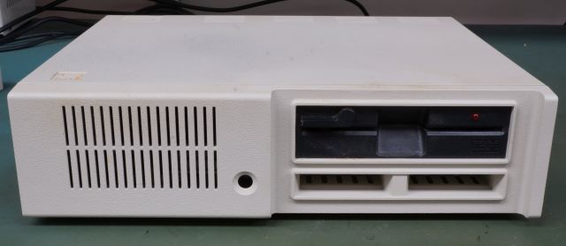

A fully configured machine โ€” internal modem, 64 KB memory expansion and diskette drive, but no sidecars โ€” leaves roughly 400 mA of +5 V for sidecars. That is not much, and a heavy or numerous sidecar load produces flaky operation rather than a clean failure. A "power" sidecar was sold to add capacity, and it uses the same external transformer.[2]
IBM PCjr with the top removed. The Power Board โ€” the second stage of the supply, and the board that carries the electrolytic capacitors โ€” is inside the system unit, not in the external transformer.
