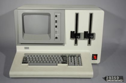

IBM 5120 Computing System. Both diskette drives, the display and the logic all run from one power supply enclosure containing two independent supplies. (Image: Wikimedia Commons, CC BY 3.0)
