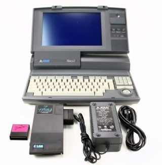

Atari Stacy Capacitor Replacement Guide
Capacitor replacement for the Atari Stacy, which Atari's drawings call the LST. The values below are from Atari's bills of material and schematics in the Stacy drawing package.[1] The main board has nine aluminium electrolytics, all rated 16 V; the 4 MB sub board has one; the lid (LED) board has five; the DC-DC converter's values are printed only on its schematic. For fault-finding see the Atari Stacy Troubleshooting Guide.
The Stacy has no mains voltage inside the case; it runs from an external DC adaptor. The DC-DC converter's input reservoir, C101, holds a charge after the adaptor is removed, so discharge it before working on that board.[2]
