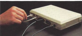

The back of the 835: telephone jacks, SIO connectors and power input
