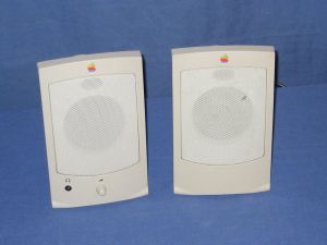

The original AppleDesign Powered Speakers (M6082): satellite speaker on the left, main speaker with the controls on the right
