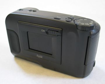

The back of a QuickTake 200: LCD, power switch and mode dial (photo: Jared C. Benedict, CC BY-SA 3.0)
Fault-finding for the Apple QuickTake 200, taken mainly from Apple's QuickTake 200 Service Source. Apple repaired the camera by exchanging the whole unit in most countries, and the Service Source has no parts list or take-apart chapter; its troubleshooting stops at the outside of the camera, the batteries, the storage card and the computer.[1] Apple's charts list the cures in order of likelihood: try the first, check whether the symptom has gone, then try the next.[1]
