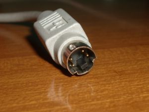

An ADB cable plug, a Mini-DIN-4 with the ADB icon (photo: Daniel Beardsmore, public domain)
Apple Desktop Bus cables are four-wire Mini-DIN-4 cables. Pin 1 is the data line, pin 2 the power-on signal (used only on the Macintosh II family), pin 3 +5 V and pin 4 ground. The total length of all ADB cables should not exceed 5 metres (16 feet).[2] The full electrical description is on Apple Desktop Bus.
Apple's keyboards came with their cables: a 1.0 m (3 ft) ADB cable with the Apple Extended Keyboard II, and a 3 ft (1.0 m) coiled cord and a 340 mm (13.4 in) cable with the Apple Adjustable Keyboard.[15][16] By 1996 Apple sold a coiled keyboard cable, a 10 ft straight cable, a 6 ft extension and a Y adapter separately.[1] Apple's 1995 article on extending ADB beyond 5 m lists only third-party products, among them Kensington's 8 ft Extra Long ADB Keyboard Cable, and warns that a much longer cable brings resistance, noise, ringing and ground problems that need line drivers or repeaters.[17]
Shut the computer down before plugging or unplugging any ADB device. On the Macintosh II the +5 V line of the ADB port is protected by a 1 A, 125 V AC normal-blow fuse soldered to the logic board, and Apple's service answer to a blown ADB fuse was a new logic board.[18][19] The Macintosh IIcx instead has resettable fuses on its ADB, serial and SCSI circuits, which recover when the computer is switched off and on again.[20]
