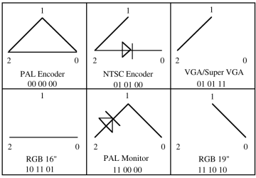

Extended sense codes
Apple's drawing of the wires and diodes between sense lines 2, 1 and 0 for each type-7 extended code (Technical Note HW 30, Figure 3)
When all three lines read 1, later video hardware drives each sense line low in turn and reads the other two. Apple calls this the type-7 extended protocol. A monitor or cable sets its code by joining sense lines to each other with wires or diodes, not to ground.[11] The type-6 extension works the same way for monitors that ground pin 4 and join pins 7 and 10 with a wire or with a diode in either direction. Apple used it for the multiple-scan displays: the Multiple Scan 17 reports itself as a "Multiple Scan 16" and the Multiple Scan 20 as a "Multiple Scan 21".[11]
Extended sense codes (Apple Technical Note HW 30, Table S-2 and Figure 4)
Monitor type Type Sense 2 low: lines 1 and 0 Sense 1 low: lines 2 and 0 Sense 0 low: lines 2 and 1
Hi-Res (12 to 14-inch) 6 10 10 11
Multiple Scan 14-inch 6 00 00 11
Multiple Scan 16-inch 6 00 10 11
Multiple Scan 21-inch 6 10 00 11
PAL encoder 7 00 00 00
NTSC encoder 7 01 01 00
VGA and Super VGA 7 01 01 11
RGB 16-inch 7 10 11 01
PAL monitor 7 11 00 00
RGB 19-inch 7 11 10 10
Each pair is what the two named lines read while the third is held low; 0 means the line followed the one held low.[11] Technical Note HW 30 gives the frame rates as 59.94 Hz for VGA, 55.98 Hz for Super VGA, 74.55 Hz for the RGB 16-inch, 74.93 Hz for the RGB 19-inch and 50 Hz interlaced for PAL.[11]
The connections Apple published for making these codes in a cable or adapter are:
  • VGA: join pins 7 and 10. The same cable works on the Macintosh LC, because the LC grounds pin 7 and so pulls pin 10 low.[10][13]
  • 832 × 624 (RGB 16-inch): join pins 4 and 10. Do not connect them to ground as well, or the computer will detect an RGB 12-inch monitor.[11][14]
  • 1152 × 870 (RGB 21-inch): join pins 4, 7 and 10 to pin 11.[14]
  • 1024 × 768 (RGB 19-inch): join pins 4 and 7.[13][11]
  • Monochrome NTSC from a Quadra or Centris: ground pins 4 and 7 to pin 11 and take the green video on pin 5 to the tip of an RCA plug, with the connector shell to the sleeve. A colour NTSC signal needs an RGB-to-NTSC converter.[13]
  • A Macintosh II run without a monitor can be made to set up a 640 × 480 screen with a plug on the video port that grounds pin 4 and leaves pins 7 and 10 open.[15]
The PAL monitor and NTSC encoder codes need a diode as well as a wire; Apple's Figure 3 shows the connections.[11]
