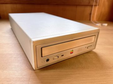

AppleCD 600e Troubleshooting Guide
AppleCD 600e (Sleeps-Darkly, CC BY-SA 4.0)
Fault-finding for the AppleCD 600e and the AppleCD 300e Plus, from Apple's shared Service Source, Apple's user guides for its tray-loading drives and owners' repair reports. Apple's charts list cures in order of likelihood: try the first, check whether the symptom has gone, and if not, refit the original module before trying the next.[1] Opening the drive is covered on AppleCD 600e General Maintenance.

Tray will not open
Press the eject button first. If nothing happens, switch off and push a large straightened paper clip firmly and horizontally into the hole next to the eject button, then push gently until the tray is released and pull it open carefully.[1] Apple's 300i Plus guide warns not to force the tray, or the front of the tray may break, and to switch off before using the paper clip, or the drive may be damaged.[2] If neither works, Apple's cure is a new drive assembly.[1]
