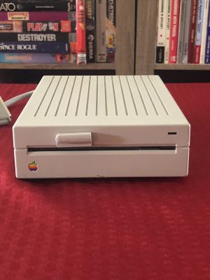

Apple PC 5.25 Drive (Apple2Guy, CC BY-SA 4.0)
Taking apart and reassembling the Apple PC 5.25 Drive, with Apple's parts list. The drive has no power supply of its own and no adjustments in Apple's documents: Apple serviced it by exchanging the drive mechanism, the cable and the case parts. General floppy drive care is on Floppy Drive Repair.[1][2]
