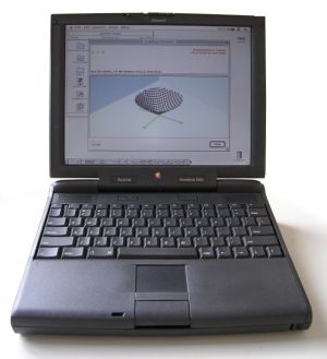

PowerBook 3400c (Neale Monks, Wikimedia Commons, CC BY-SA 3.0)
