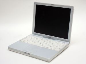

A white iBook G3 Dual USB (baku13, Wikimedia Commons, CC BY-SA 3.0)
