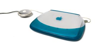

A clamshell iBook (Felix Winkelnkemper, Wikimedia Commons, CC BY-SA 4.0)
Routine work on the PowerPC G3 iBook covers the battery, the memory slot under the keyboard, the clamshell's carrying handle and the parts that age. The procedures are from Apple's Service Source for the clamshell iBook and iBook (FireWire) and Apple's replacement instructions for the iBook (Dual USB).[1][2] Fault-finding is on iBook Troubleshooting.
