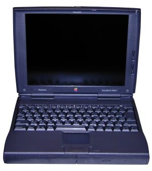

PowerBook 1400cs (GeneralFreddy, Wikimedia Commons, CC BY 4.0)
Fault-finding on the PowerBook 1400 series starts from Apple's symptom charts and startup flowchart in the Service Source, which work at module level: try the cures in the order listed and test after each.[1] The charts cover all six models; where a cure differs between the active-matrix 1400c and the passive-matrix 1400cs, Apple says so.
