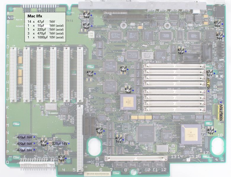

Logic board 820-0282-B. This board is unlike any other Macintosh board of the period: it has two sets of pads at every 47 µF position, one for a tantalum and one for an aluminium electrolytic, and Apple populated boards with either type or a mixture of both.[6][7]
Twenty positions in all:[6][5]
Macintosh IIfx logic board 820-0282-B
Value Working voltage Quantity Package
47 µF 16 V 14 Surface-mount — tantalum, electrolytic or a mix
470 µF 16 V 3 Axial
220 µF 16 V 1 Axial
10 µF 16 V 1 Axial
1000 µF 10 V 1 Axial
MacDat's list and Recap-a-Mac's annotated photograph give exactly that complement, and Console5's per-designator list for 820-0282-B agrees.[6][5][7] Apple published no component-level capacitor data for any Macintosh of this era, so all three are readings of physical boards — but three independent readings agreeing is about as good as this gets.
Macintosh IIfx logic board 820-0282-B. The two battery holders are at right beside the ROM area; the five axial capacitors are at lower left and lower right. Source: Recap-a-Mac.
What to actually replace
Whichever mix your board has, every aluminium surface-mount electrolytic on it must go. Those are the parts that leak, and the commonest factory configuration is mostly tantalums with two electrolytics near the battery holders — which is the worst possible place for them, because that is also where a leaking cell does its damage.[6] Look carefully: a board that appears to be all tantalum often is not.
The five axial parts are easy to overlook because they do not resemble the rest. They are electrolytic and they age.
C1: the capacitor that explodes
If C1 on your board is a factory tantalum, treat it as a fault waiting to happen. The position is a 47 µF 16 V part on a rail running at around 12 V, and 16 V is too little derating for a solid tantalum in that service. Reported failures range from a shortened life to the part detonating.[6]
  • Check whether it has already gone — a cracked, split or scorched moulded block.
  • Replace it with a 47 µF 25 V part rather than a like-for-like 16 V one.[6]
The general rule behind that: a solid tantalum wants roughly twice the working voltage of the rail it sits on. A part on a 12 V rail wants 25 V, and a part on 5 V wants 10 V or more. Tantalums fail short, so an under-rated one does not quietly lose capacitance — it pulls its rail down or burns.
