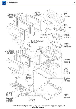

Apple's exploded view of the Macintosh Portable with module part numbers (Service Source, PDF p. 151)
The Macintosh Portable comes apart without screws: the rear cover and keyboard cover are held by latches, and the logic board sits on a plastic subframe held by clips. Apple warns that it contains CMOS devices very susceptible to static, so work on an earthed mat with a wriststrap throughout.[1] The same procedures apply to the backlit model.
