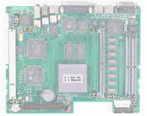

[[File:Mac LC 475 Recap Guide.jpg|thumb|300px|Macintosh Quadra 605 / LC 475 logic board 820-0364-A. Nine 47 ยตF and two 100 ยตF parts, and no 10 ยตF parts at all. Source: Recap-a-Mac.]] | |||

[edit | edit source]Eleven surface-mount electrolytics on logic board 820-0364-A: nine 47 ยตF 16 V and two 100 ยตF 6.3 V. Two independent community sources โ Recap-a-Mac's annotated photograph of the board and MacDat's reference list โ give the same complement.[3]
There are no 10 ยตF parts on this board. Lists that put four of them on it are copied from a different machine. Designators, the board photograph and the full procedure are on Macintosh Quadra 605 Capacitor Replacement Guide and Macintosh LC 475 Capacitor Replacement Guide.
Unlike the LC III, this board's bulk capacitor on the โ5 V rail is wired the correct way round, so an 820-0364 with serial-port faults after a recap has a genuine fault rather than the LC III's silkscreen error.
