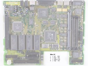

Macintosh LC logic board 630-0309 with every electrolytic marked with its value, working voltage and positive terminal. Source: Recap-a-Mac.

Capacitors
Fifteen surface-mount electrolytics on logic board 630-0309: eight 10 ยตF 16 V, five 47 ยตF 16 V, one 100 ยตF 6.3 V and one 1 ยตF 50 V.[3] The per-designator list, the revision note about C9, the board photograph and the full procedure are on Macintosh LC Capacitor Replacement Guide.
Sound goes first on these boards, then intermittent starting, then visible residue. A leaking surface-mount electrolytic does not have to look swollen โ€” the usual failure is a seeped seal, and the evidence hides under the can. See Capacitor Failure Symptoms.
